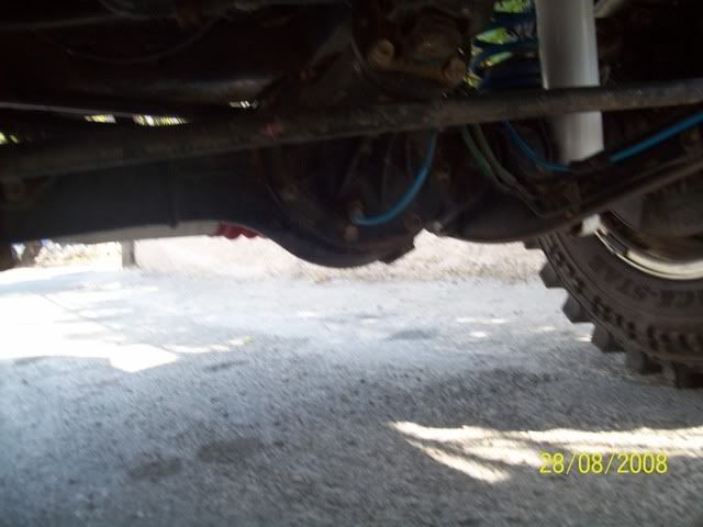

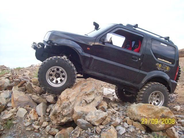

T.CASE FROM SUZUKI SAMI 6,5:1,
ARB AIR LOCKERS
FRONT-REAR,4,3:1 RING&PINION,
28 SPLINE AXLES FRONT&30 SPLINE AXLES REAR,
4 SPEED TRANSMISSION
SJ410,CLUTCH CENTERFORCH,
ENGINE 1,6LT,FROM VITARA,
SNORKEL TJM,
RIMS PRO-COMP,
TIRES 32X10,5X15 MUD TERAIN
SHOCKS&SPRING 6''
DOETCH TECH ,
5''PITMAN ARMS
BRAKE FRONT FROM DODGE DAKOTA
2'' BODY LIFT ,SPACERS WHEELS
2'' ,STABILIZARER PRO-COMP
HUBS SUPER WINCH
DRIVERLINES HEAVY DUTY FROM CALMINI
EXHAUST PERFORMANCE CALMINI
ELECTRIC WINCH MILE MARKER 9500LB,
